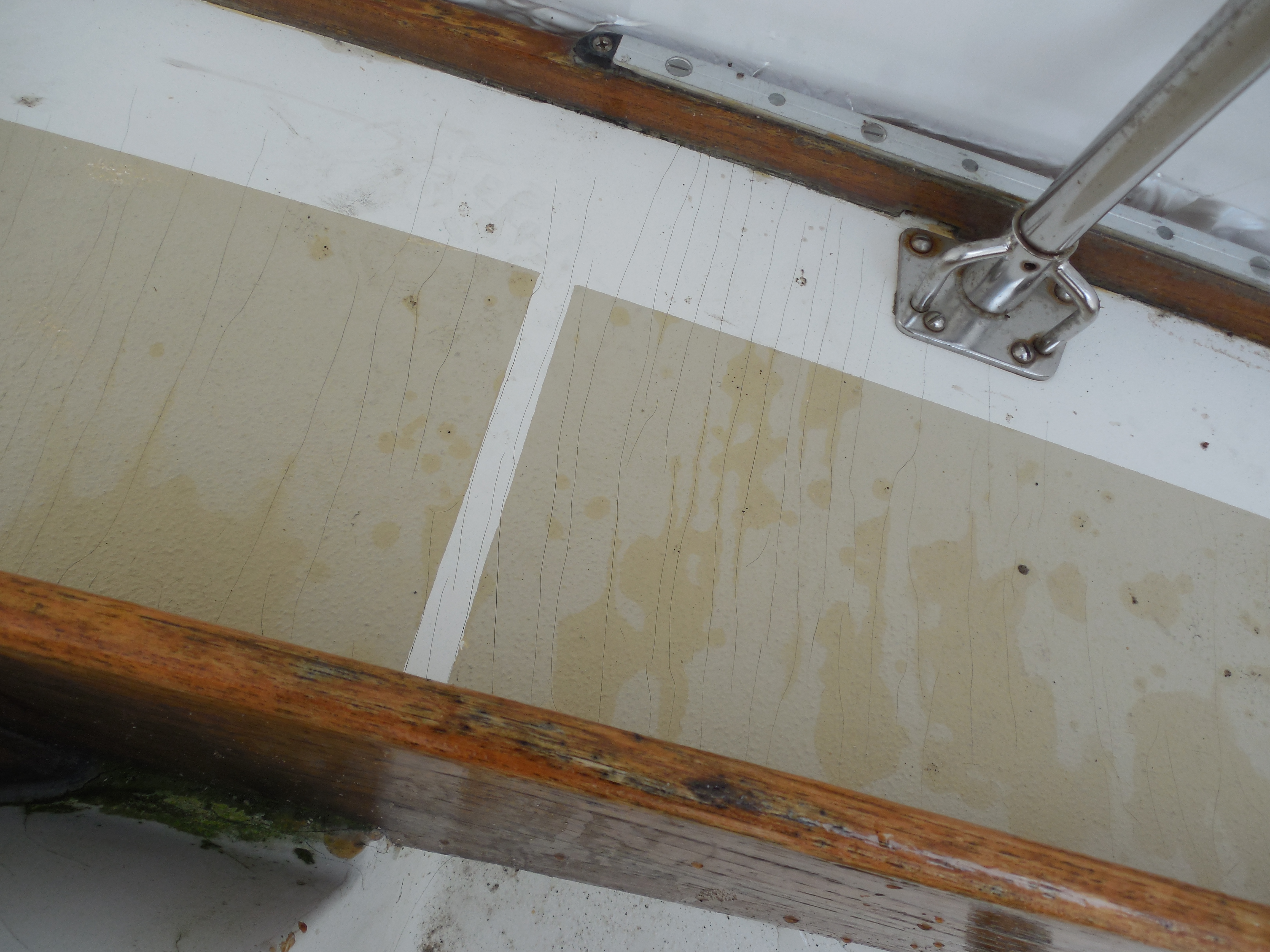

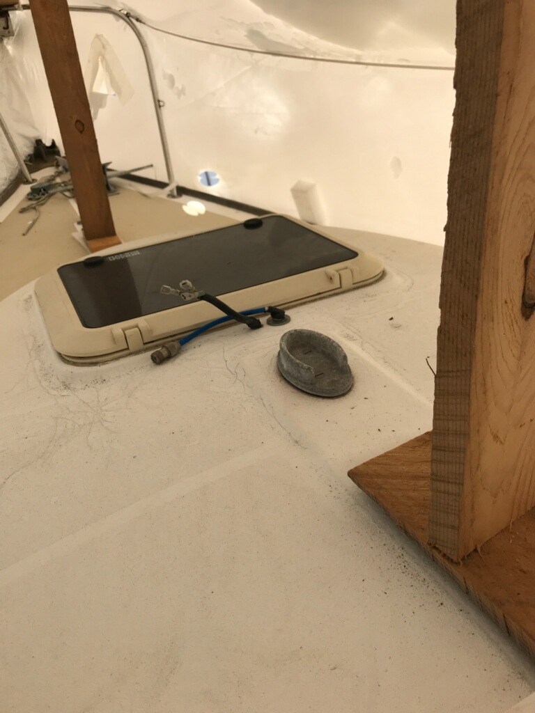

Lately I've seen several CD22s and a Typhoon Senior that had significant topsides gelcoat cracking on the foredeck and side deck nonskid, cabin house non-skid, smooth cabin house gelcoat and cockpit floor non-skid (I've attached a few examples). While there are several theories about why there is so much topsides gelcoat cracking on Cape Dories, my interest is in understanding when the repair is within the capabilities of the owner (e.g., say using the rolled-on Kiwi Grip Non-Skid Deck System or rolled-on one-part polyurethane) and when it is best left to a professional (e.g., sprayed-on gelcoat or 2-part polyurethane). And while I can see the owner using the Kiwi Grip to make a textured surface, I have no idea how an owner could make large portions of smooth gelcoat, although I've seen examples of professional spray-application of gelcoat that could do this). Would be interested in hearing from owners who have either done the non-skid and/or smooth gelcoat repairs themselves, or decided to have a boat yard do the repairs (which I've heard can be quite expensive). For purposes of responding, please assume that the underlying laminate and balsa core are undamaged, and we're just talking surface gelcoat repair only. Thank you!

Thanks so much Jean, both for the technical tips and encouragement! I was able to find the article you referenced on-line. One of the pointers was to use System Three SB-112 because it will bond to the polyester gelcoat. While I'm feeling good about doing the non-skid portions, I'm still not so sure about the smooth portions (e.g., between the tan non-skid on the side decks and the teak toe rails (see Photo 3), or on the portion of the cabin house on the TY Senior near the mast base and foredeck hatch where it is smooth, and a single smooth line that proceeds downward from aft of the mast base on either side bisecting the cabin house non-skid (see Photo 2)).
