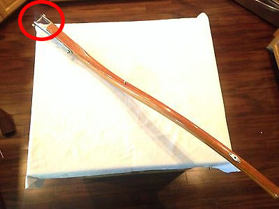

As mentioned by Roberto, it should have a single bolt that goes through the tiller bracket and tiller (see picture). The play could be because of this bolt being loose, there being a gap between the tiller post and bracket, or the hole through the tiller post itself is worn larger than the bolt. I have never repaired this, but I have sailed boats with this issue and know that it's annoying. I also have a CD 25, so it may be different on the 28.
