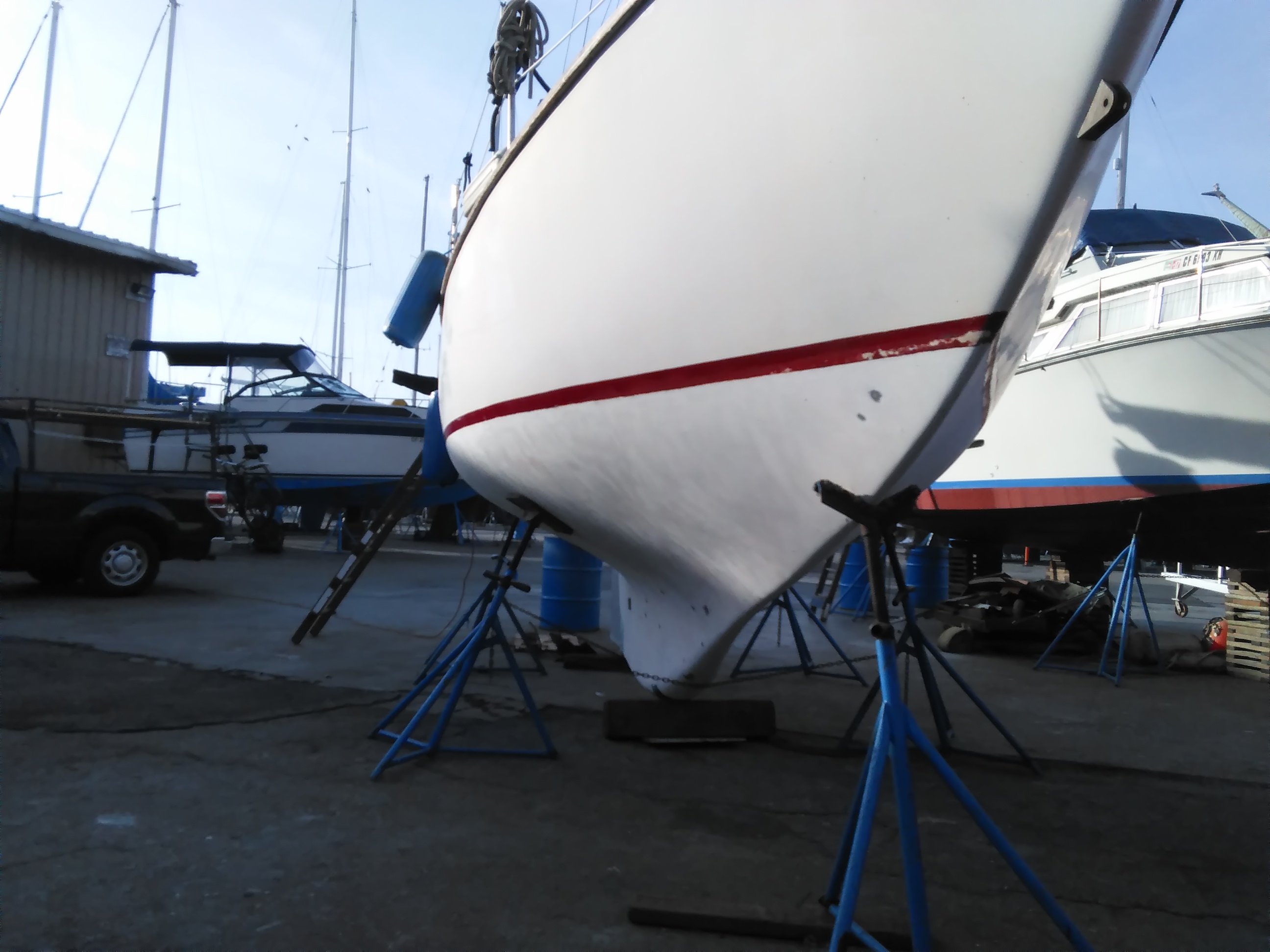

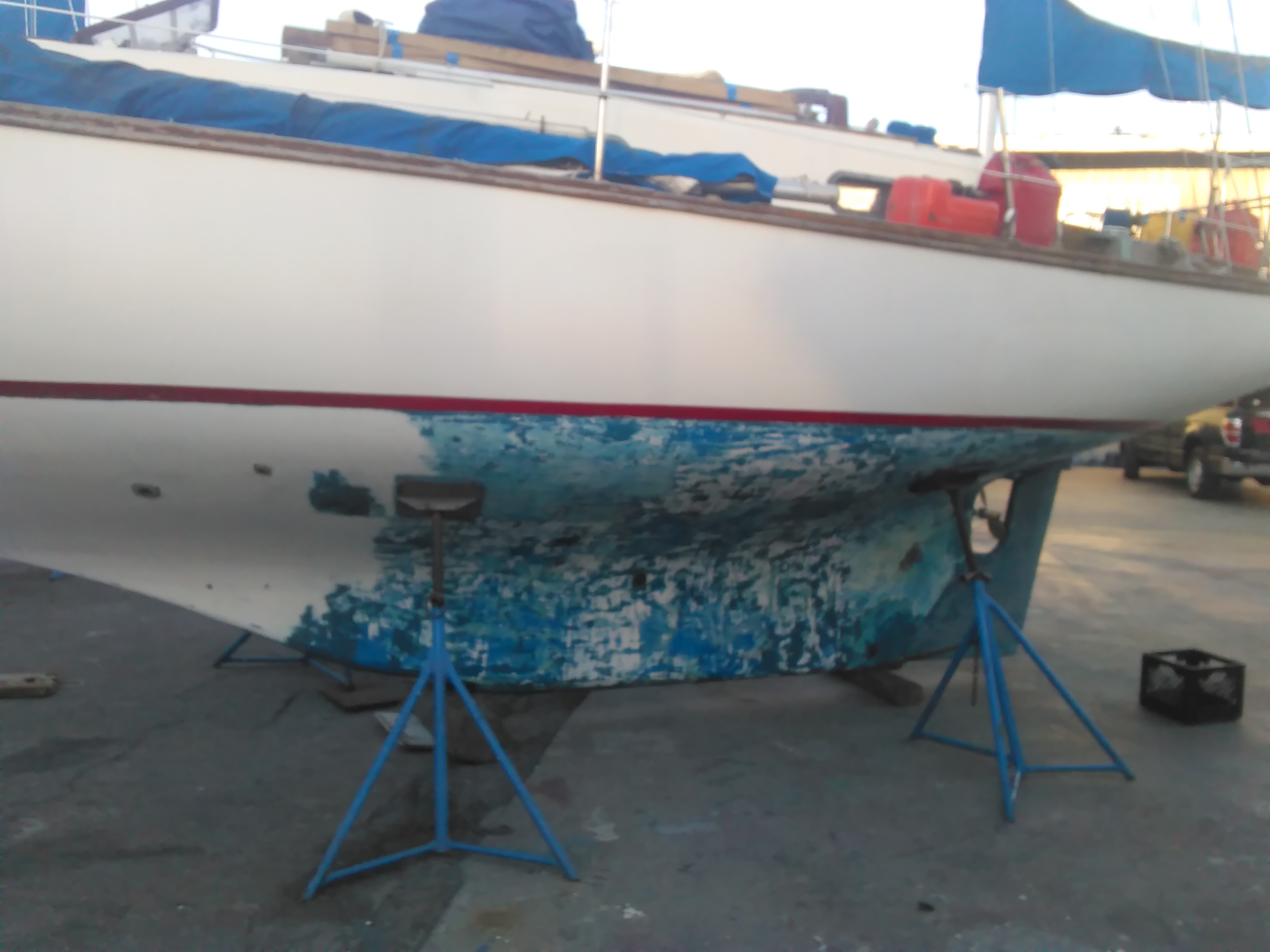

Putting progress photos up especially for Roberto. Stripped several layers of paint off the bottom and they are sanding the rest. It looks pretty good to me. The yard is not recommending the barrier coat. They said that after they strip all the paint they measure the moisture content and when its too high the epoxy just traps it in ??? .They are not too excited about doing the backing plates. I removed all the chain plates and thru bolts and started working on the bow plate. After 4-5 hrs I decided to let the yard try Hopefully they have more experience and some tricks up their sleeves. I would appreciate any suggestions I couldn't get very good access to the side plates so the photos aren't very good. Also can anyone recommend how I should modify the bowsprit so I can use a windlass. I'll put that photo next time. Thank you.

I have had a surveyor tell me the same thing about barrier coating a wet hull. He said the boat would have to be out of the water a long time for it to dry out enough for the barrier coat. Paint the bottom and get back in the water as soon as you can and go sailing!

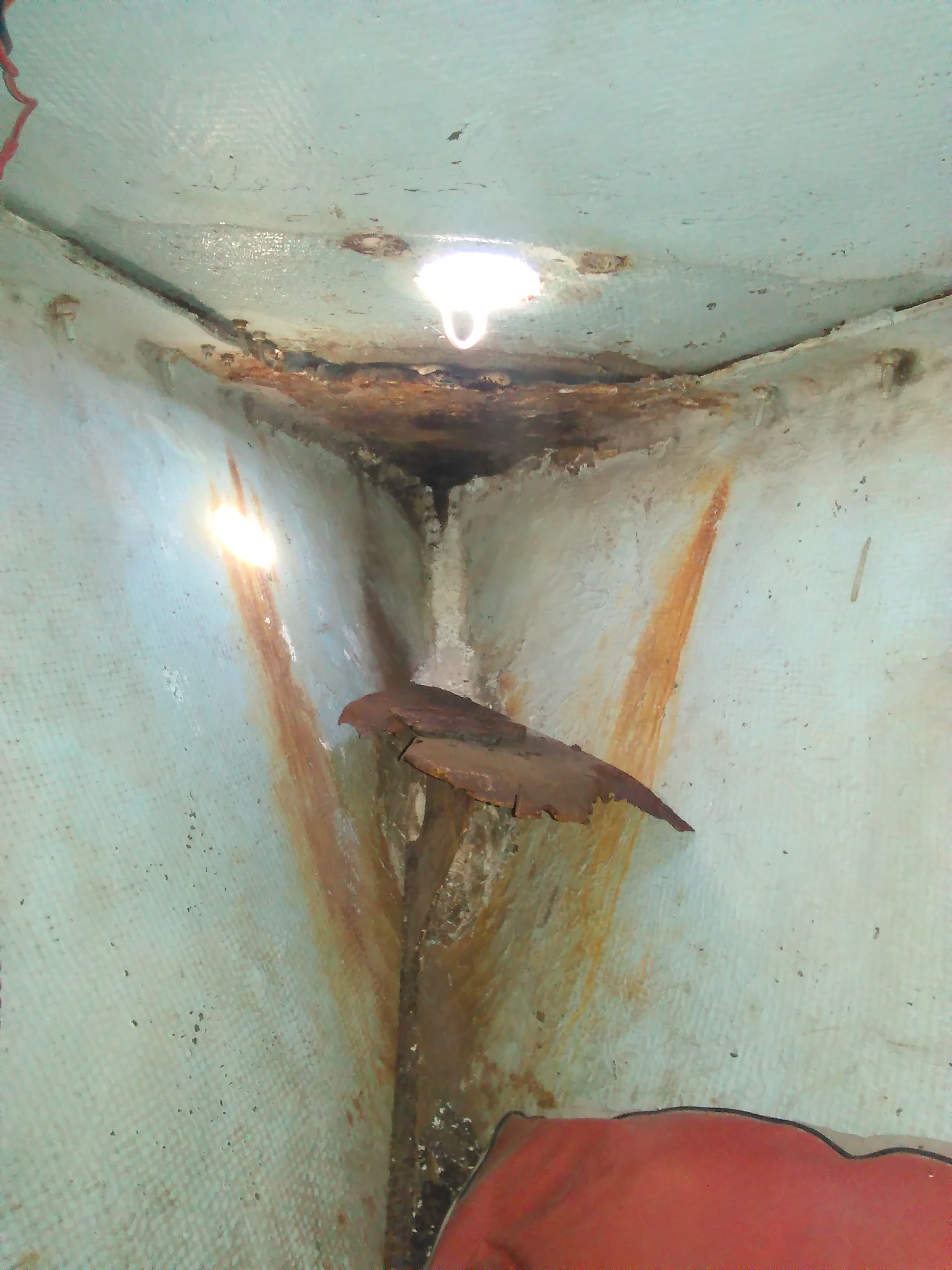

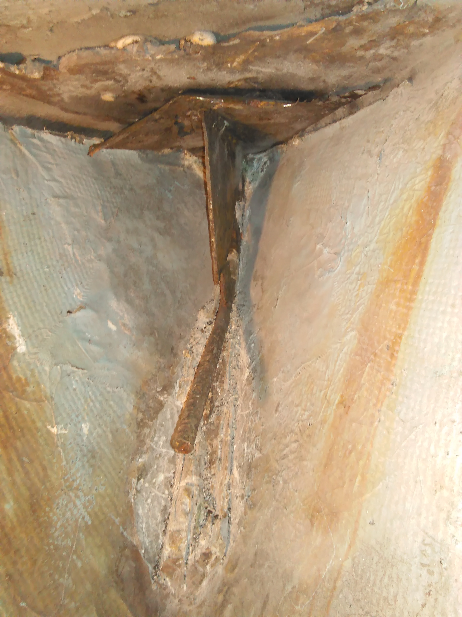

Thanks everyone for the helpful comments. I went back up to San Fran to check progress on the "Leoma",. They haven't done any more. I did tell them to take their time since I don't plan to sail the boat down to LA till August and I could use the time to save more money. I spent another 6 Hrs. on the bow plate and don't feel like I'm making any progress. Here is a photo. The top sides are falling off and are not connected. I think Its just that little bit of bond way up in the point. I've been kinda grinding it out with a long drill bit. It won't budge. I feel like there is another fastener hidden in the deck or in the bow. I'm feeling too old for this. It's killing me. The yard charges $135 per hr. and they are encouraging me to do what I can. But with the cost of driving up there and the lost income at home, I really don't think my contributions are helping. I don't make the big money like those Silicon Valley people but I think They would do it much more efficiently. Oh ,one of my bronze deck plates is broken but how do I know if the rest are ok besides wear around the holes? Does bronze last forever?

John, It looks like you have made great progress! You are doing everything the way that worked for me, including the long drill bit.
You might try putting on some ear and eye protection and striking it in different directions with a large hammer.
If nothing else, it is a great way to relieve some frustration. If you keep at it, it really will just fall out.

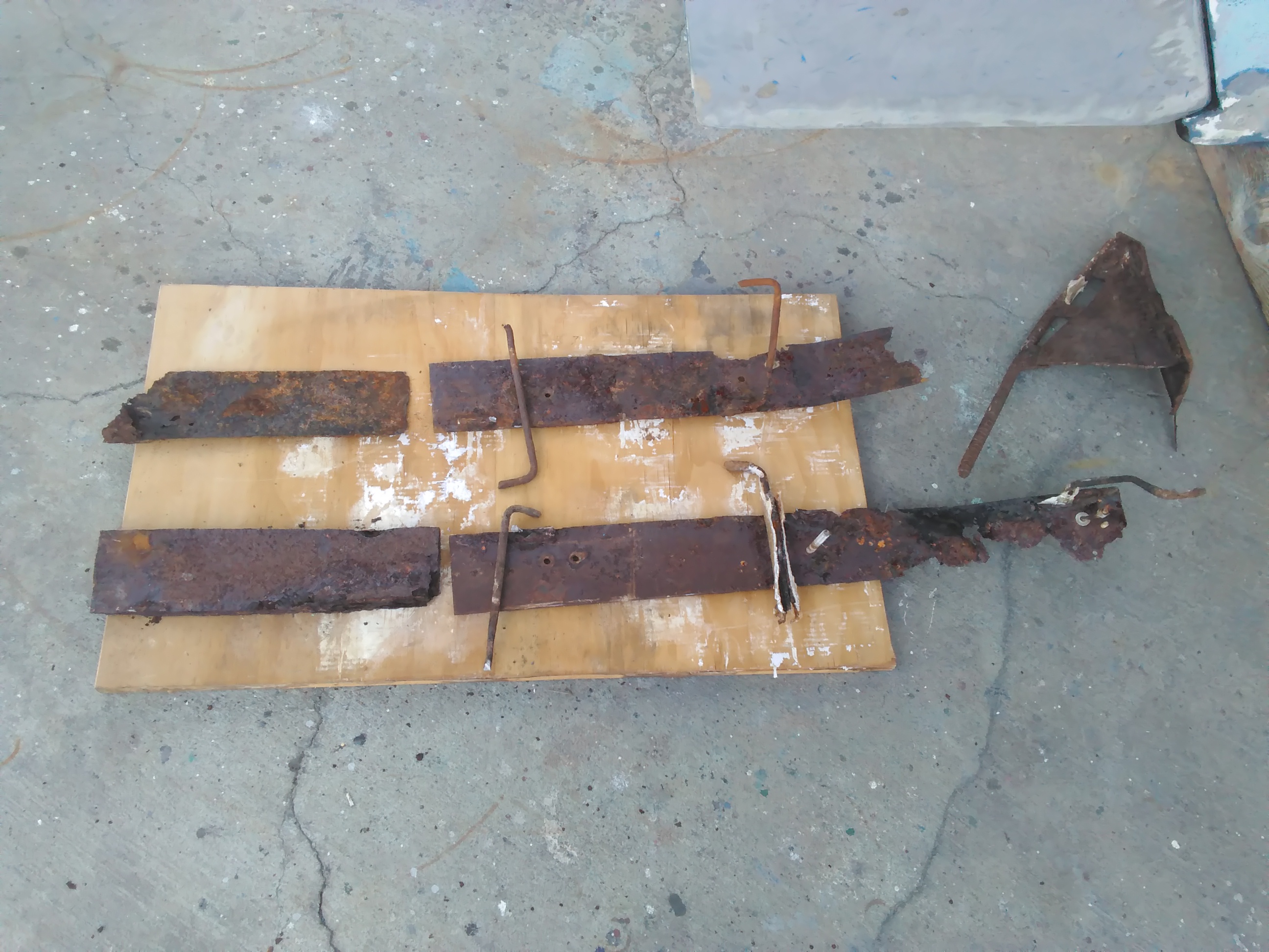

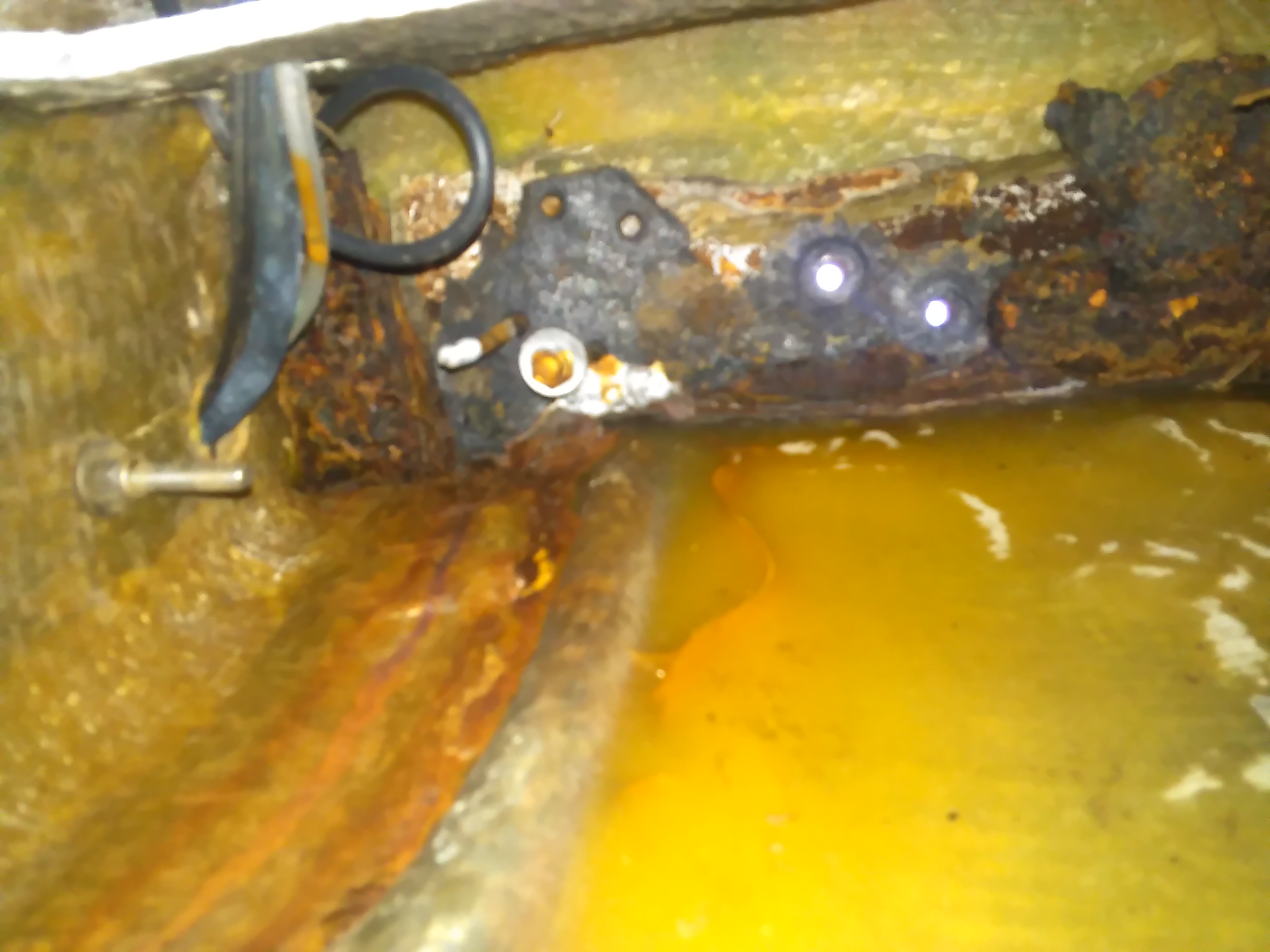

Yea! I got them out. Thanks to Jonathon I got a new spirit . When I got up to San Fran on Friday I used bigger crow bar and wiggled and pried the bow plate and out came out easy. Then I continued with the sides and by noon I had them out. I not gonna do the other s till I know how much $ I still have. The backs don't look bad but the forward ones of the Mizzen are terrible. But I can get the boat to LA without the mizzen. But I still have three months so I will probably make enough to complete these. I wonder why the sides have a piece separate of the actual backer plate extending aft of the main bulkhead. you can see in the photo the piece about 12" long. is so rusty but It doesn't seem to have been all one piece
