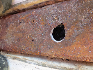

The single exception is in the are where a hole was drilled for the (poorly sealed) mast wiring and rust had chewed through about half of the thickness of the steel over an area of an inch or two square. This rusted area was the cause of the visible cracking which had us worried that the mast step was sinking. It turned out that the opposite was true. Mild steel expands as it rusts, sometimes to something like double its original thickness, and this expansion was pushing the fiberglass upwards and creating cracks.
The one area showing significant corrosion damage

This boat is forty years old, as are these mild steel structural elements. For at least the past few years a poor seal for the mast wiring has allowed rainwater intrusion into this structure. In spite of this there is surprisingly little visible deterioration of the steel, aside from the approximately two inch square area where the hole for the wires was drilled. Luckily this is not directly under the mast and shouldn’t weaken the rest of the structure a whole lot. Aside from the relatively minor fiberglass cracking from rust expansion there are no telltale signs such as extensive gelcoat cracks or sagging of the cabin ceiling which would indicate a loss of structural integrity. There is also no history of mast step failure in these boats that I’ve heard of, despite there being hundreds produced. Given this, and the fact that these boats are massively overbuilt to begin with, it’s clear that there is no real need for repairs or structural reinforcement at this point. Actually we’ll be just fine if we leave this structure as is, maybe with a protective coat of epoxy to delay any future corrosion and glue back on the fiberglass that we removed to expose it.

First, there’s that rust spot. An easy reinforcement is epoxying a new piece of reinforcing steel over the damaged section. Since weight is no major concern and steel is cheap we decided to cut a larger piece which extends over the area that the mast rests on.
The damage section before rust cleanup. We enlarged the hole for the mast wiring so we could better inspect the interior. This will be covered with a piece of flat steel reinforcement
Mast wire hole enlarged.jpg (40.41 KiB) Viewed 508 times
