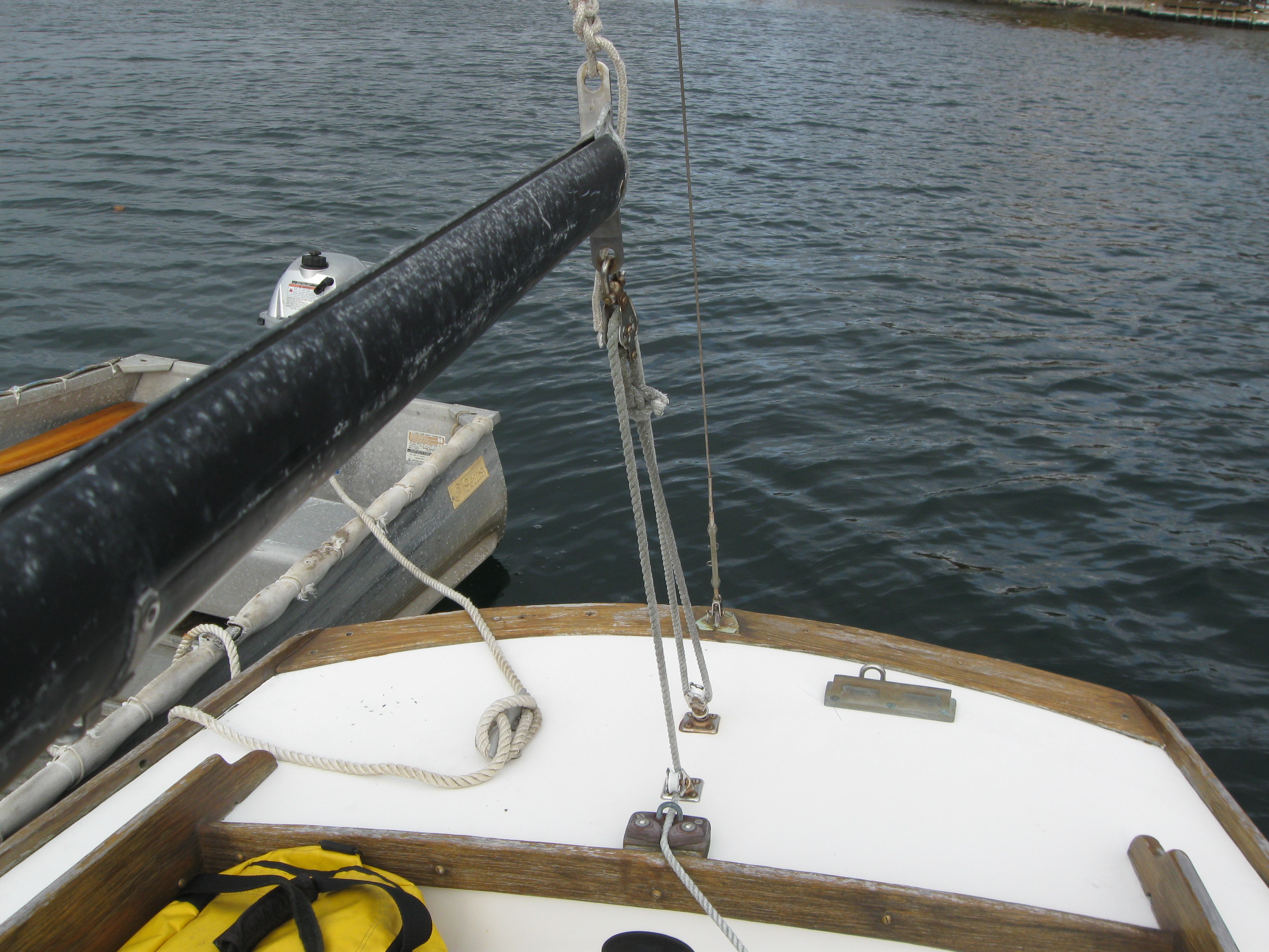

My project boat has a makeshift topping lift attachment to the boom. Is someone willing to post a photo of what it likely looked like in 1975? Thanks in advance!

I don't know what it looked like in 1975, but this is how it looked in 1985 (with a few new pieces).
- IMG_2384.JPG (98.69 KiB) Viewed 881 times
- IMG_2383.JPG (103.07 KiB) Viewed 881 times

Jeff,
Thanks for the photos. I think I need to update my boom. It's a roller reefing version which I understand from other posts was never ideal. It does not lend itself well to the conventional topping lift cheek block leading to a boom mounted cleat. I also read that sail shape is poor with this type of reefing arrangement, which is understandable.
Here's a photo of what came with my boat; you can see the makeshift arrangement! Thanks again for your post!

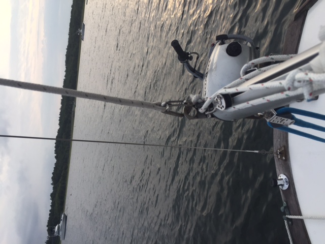

Other than the black paint your boom looks the same as mine. I added the carbine hook to make it easier to remove the topping lift. I also added the outhaul block that was in my earlier post. When I bought my DS it too had roller reefing. When I purchased a new main I had one medium reef installed and replaced the gooseneck assembly with one set up for jiffy reefing. The other line in my earlier post is the aft jiffy reefing line. I purchased the parts from Rig Rite, which while they took a long time to arrive, fit well.

I'm not sure if this helps but this is the simple reefing system I employ via a Dwyer reef hook attached to my original gooseneck, then a one-piece tang at the end of the boom similar to others systems like JeffD shows and then I have a topping lift which I hook into the tang which ascends to the top of mast to a cheek block then back to a mast eyelet where I quick tie it for releasing and hauling up.
In the next photo is a close up of the end of the boom:
Hope some of this helps you decide what you want? I'm not sure what ideal would be for each person, but I have come to work with this and actually find it rather simple to employ the reef and to de-rig once out on the water when I raise the mainsail. Easy-Peasey.
