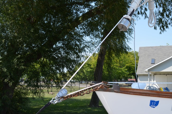

I determined on setting up the rigging alone that I was going to have to be very careful to respect this body's limits so I made some assurance of safety in each step I took. This is one of those steps; a ratcheting block attached to the trailer winch strap. Once the rig was up, and yes it is heavy, the slight balance of stays allowed me to reach down and grab this line and cleat it off, thereby securing the rig from leaning back while I climbed down and attached the roller furling assembly.
Update 11/2014: This method in reverse allowed me to lower the mast completely w/o carrying any of the weight, simply by releasing tension on the line. Slow and smooth.

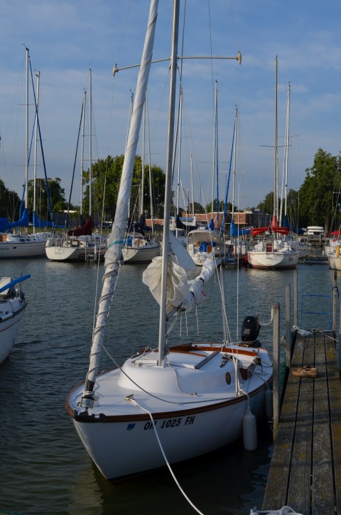

And here she is at the Sandusky Sailing Club. She's the smallest in size on my dock but definitely one of the largest as far as having some serious class!

Glad to finally have found this redo. You've done a splendid job on her!
I agree with Chris that using Permalac is a great option for the winches. Mine are holding up very well. I would like to find some new winches themselves--if anyone has a lead on the originals? Mine are Gibb or something like that. I cannot find them anywhere.
Good reference too on the method for holding the forestay/furler for installation and safety. I like the trailer winch option. Will think about that next time I'm fiddling with my mast alone again.
