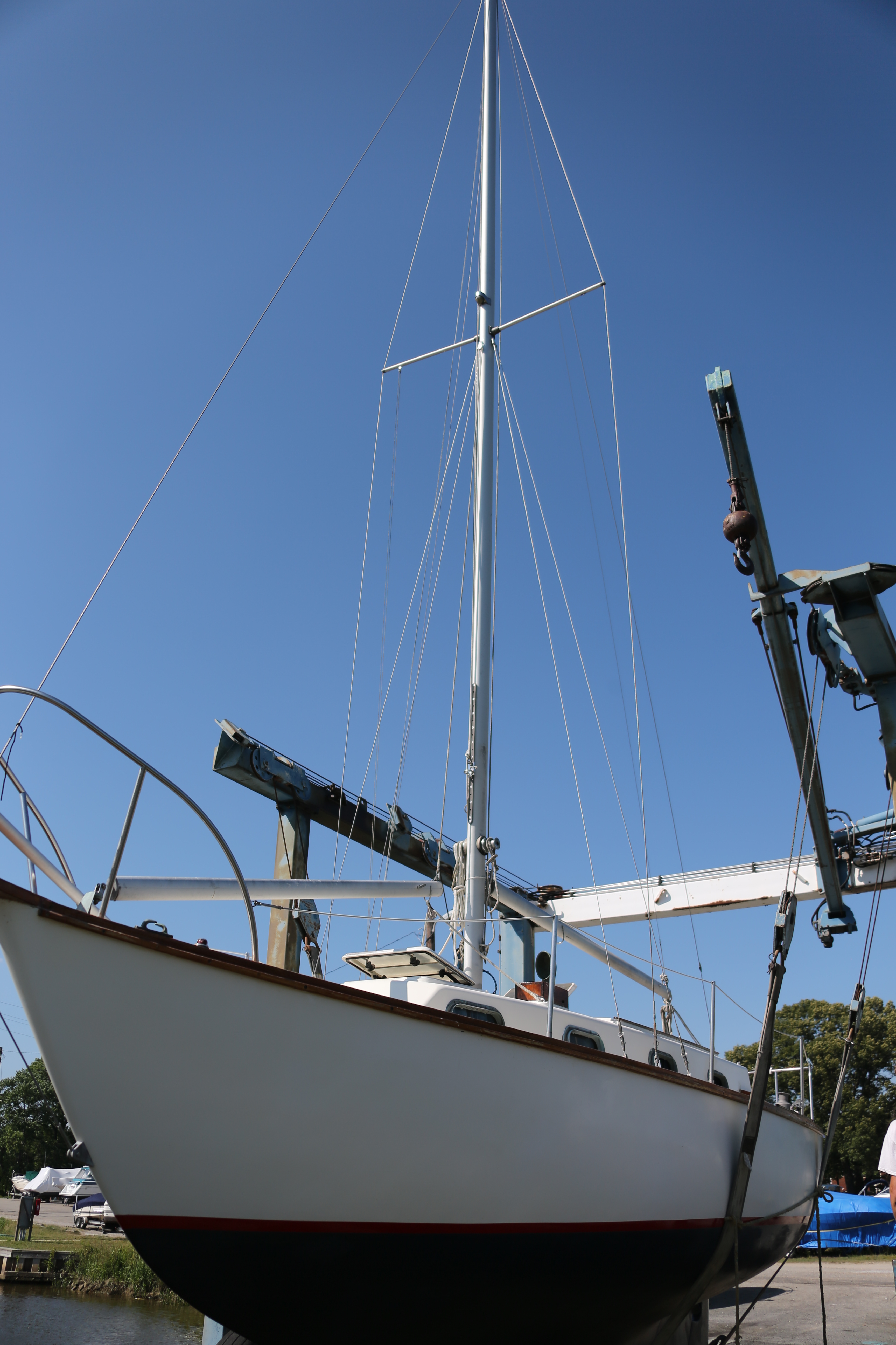

I finally got CHASSEUR back in the water after a total of 13 years. Previous owner had it on the hard for 12 years and it took me a year to recore the cockpit, foredeck, strip and barrier coat the hull, repair the Volvo Penta 2002 reduction gear (blown oil cooling line), and rebuild the raw water pump. While I had the transmission out (done without removing the engine which is doable if one does not mind working in a coffin type environment while on one’s stomach with one’s feet elevated at about 25%) I decided to put in a new stainless shaft, replace my cutlass bearing and put in a dripless system. I’m glad that I started things out last June with doing the bright work since the gleaming teak kept moral up. That being said, its time to do it all again.

Lost coolant on the engine about a mile outside Quantico Marine due to the heat exchanger bolt backing out, I say bolt since I only found one. The loose heat exchanger caused the pressed in copper line to separate from both the heat exchanger and the engine. As a result I lost coolant via both ends of the copper tubes the provide water via the raw water pump. Two bolts at .62 cents apiece should fix thing right up and they are due in today. I’ve also ordered replacement rubber seals that go around the pipe……is replacement necessary and are there any suggestions as to removing the old ones? I figure I would use a tool to gently pry the old ones out but figured that there might be a trick to doing it. I ordered new ones but do they even need to be replaced after each removal or only if they are leaking?
