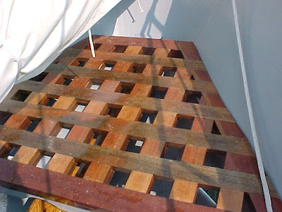

The picture is that of a grate I built for our schooner. At the time of the photo, the wood isn't finished. It is being final fitted to where it goes. After adjustments, I used exterior urethane and added a very fine grit that came in a salt-shaker type container. I got it at Ace Home Supply, if I remember correctly.
Once, I tried using sand but found that it was entirely too coarse . Better to stay with prepared fine grit.
